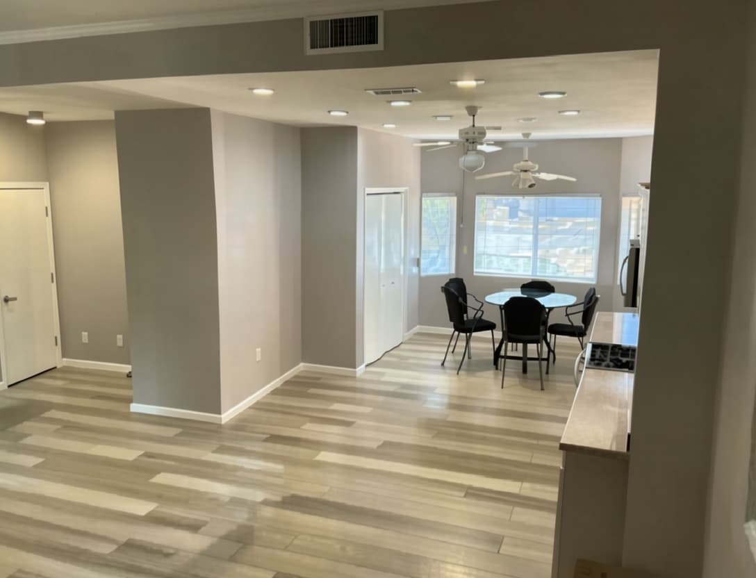

trying to get stainless steel side by side fridge in corner of my design next to pantry. I have tried the replace command and have used the partial remodel and the fridge is always recessed into the walls. How do i get this operation to work. Attached is my rendering

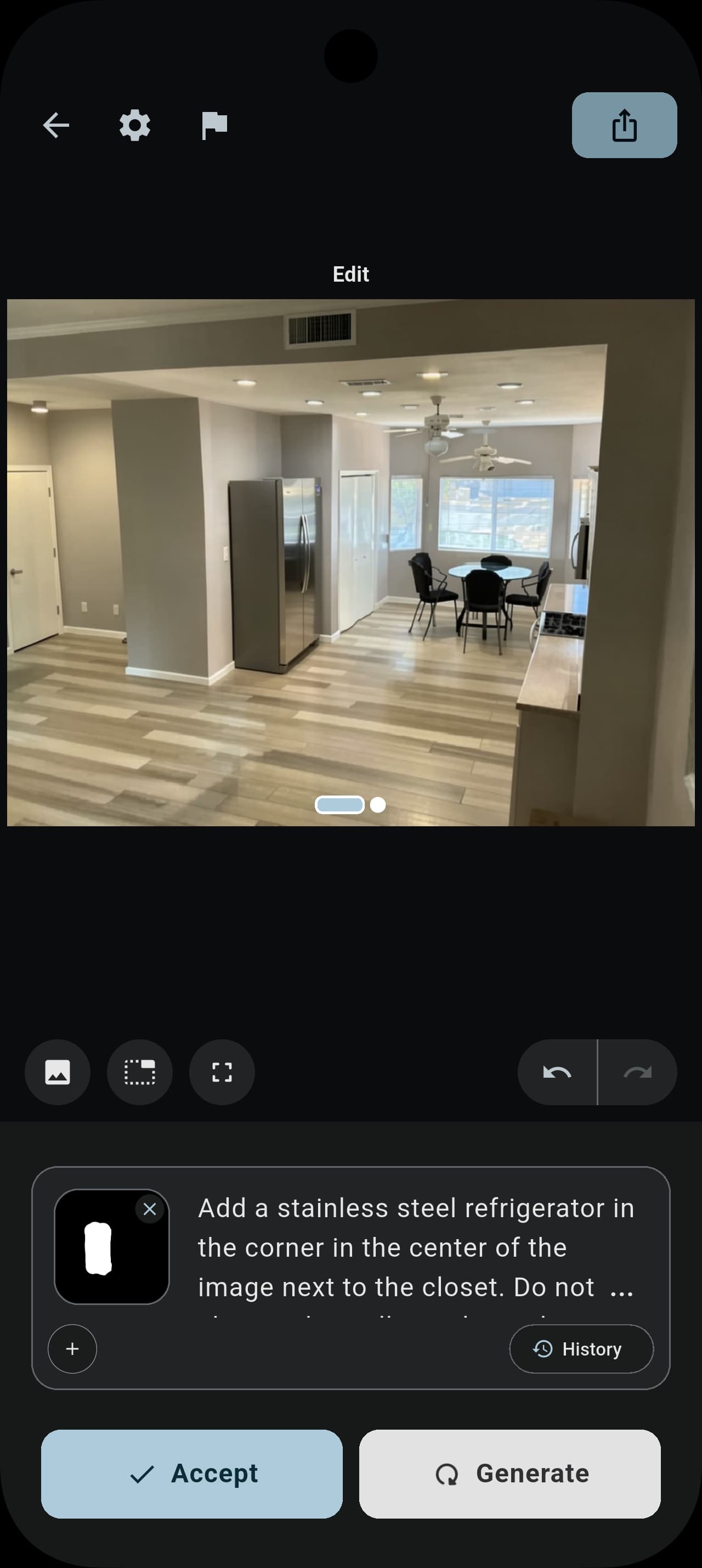

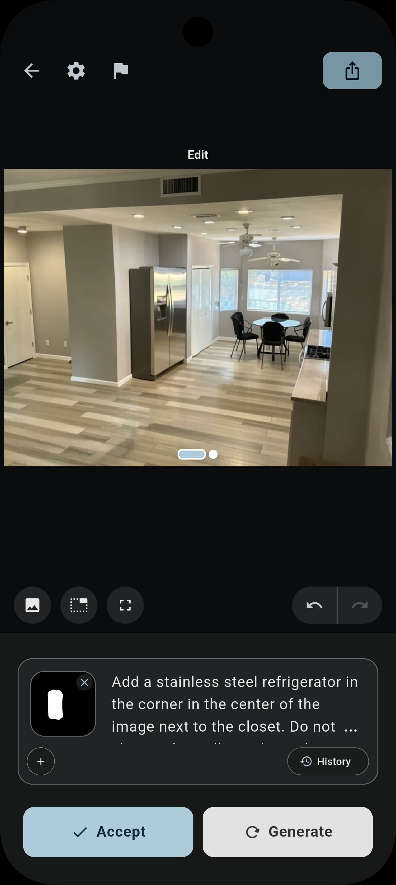

I was trying something like: “Add a stainless steel refrigerator in the corner in the center of the image next to the closet. Do not change the walls or closet doors. The refrigerator should be a double door facing to the right - the depth of the refrigerator should be the depth of the existing wall”

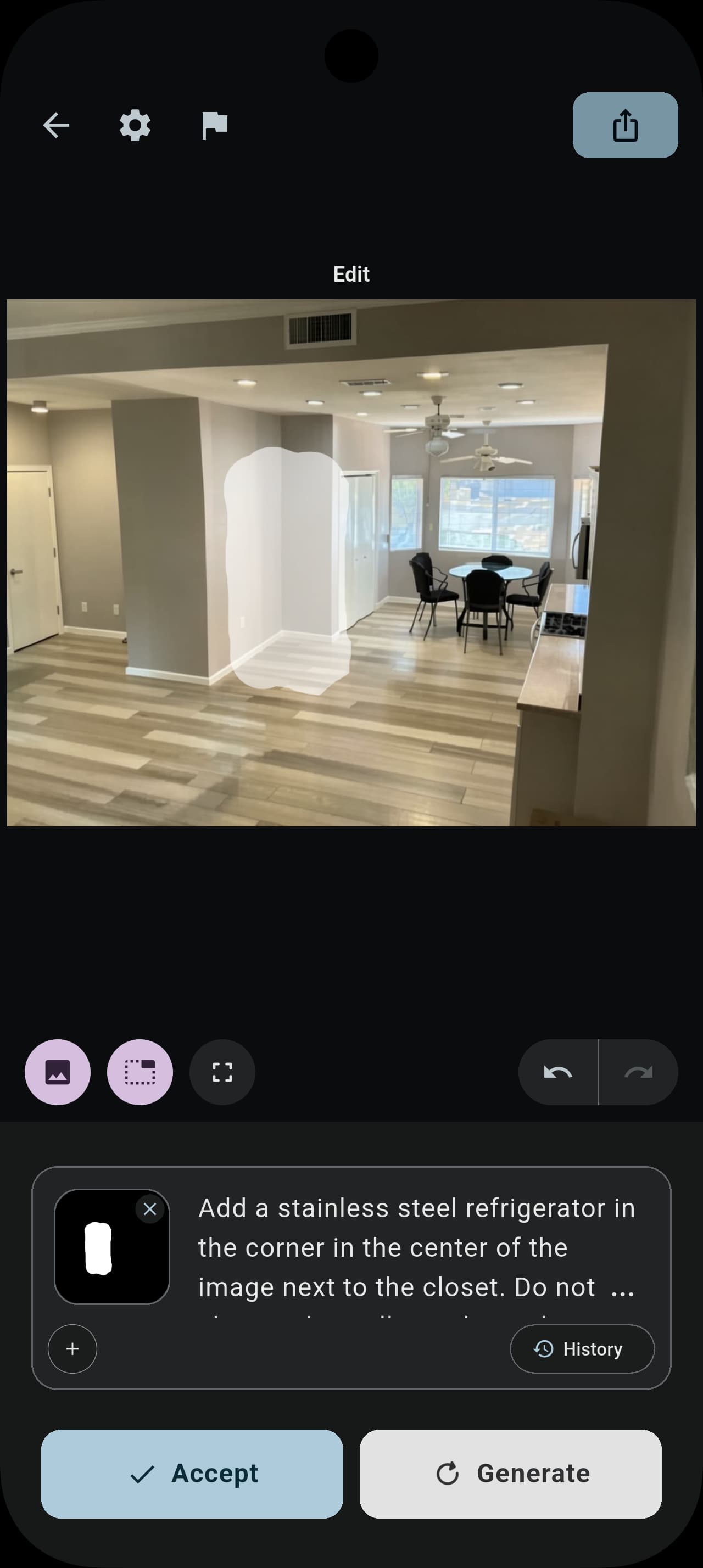

It was still wanting to change the closet doors (the pantry?) so I just added a mask to limit what its allowed to change.
Also remember to try a few times with each prompt as not every “seed” is good and the next results might be better.
to add a mask click the plus button and attach a mask:

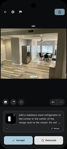

beware, just because AI makes it fit doesnt mean it will fit of course.
To me it doesnt look like even a counter depth fridge will fit there, which might be one of the reasons AI is trying to move the wall, because it knows that fridges are usually deeper.
